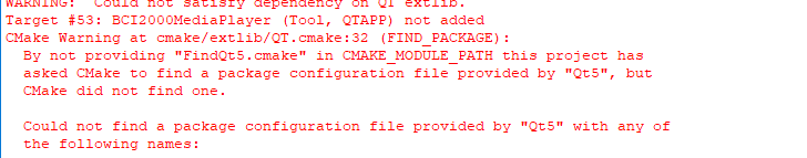

I was following these steps to build BCI 2000: https://www.bci2000.org/mediawiki/index ... ompilation
I encountered an error (Attached) when pressing "configure" in cMAKE. Everything else before that was working fine. Any thoughts? Is it because of the newer version of cMAKE or another software? The SVN part worked fine.

make sure that the Qt5_DIR path points to an actual Qt installation on your harddrive, don't copy the example path from the wiki.
