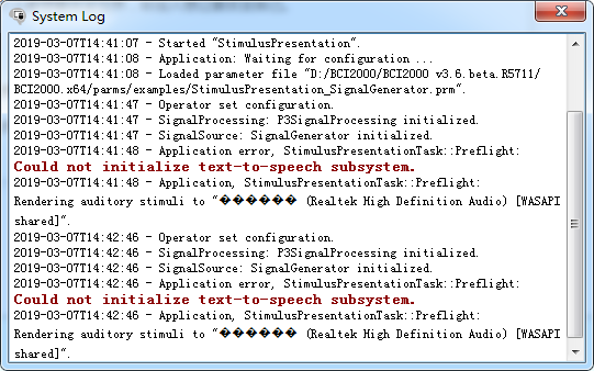

hi all
im using StimulusPresentation_SignalGenerator function, when i click "set config" button after i load "P3Speller_CopySpelling.prm"
it appear "Could not initialize text-to-speech subsystem" as shown in the picture.
Could you please help me solve these problems?
Regards.
Re: StimulusPresentation_SignalGenerator problem
Post by mellinger » 08 Apr 2019, 12:00
Make sure you have installed the Microsoft Speech Platform Runtime in the bitness (32 or 64) that matches the BCI2000 exectuables you are running.
