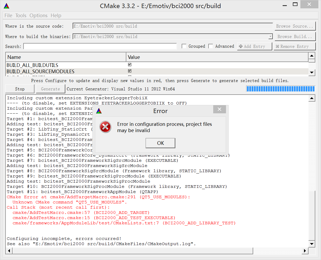

When I have compiled the bci2000 src in VS2012, I found there are some on-line system executables missing in the folder "E:\Emotiv\bci2000 src\prog".
Some of them are :BCI2000Launcher.exe, BCI2000Launcher.ini, FeedbackDemo.exe, Operator.exe, Operator.ini, P3Speller.exe, StimulusPresentation.exe.
And I need to know where in the code is the key position to modify the flashing behavior of the P300 speller.
From http://www.bci2000.org/phpbb/viewtopic.php?t=2180, I tried to found StimulusTask class in the VS2012 but returned nothing. Then I checked the structure in VS, I found there is no "Application" in the "Core" module. There must be something wrong with the compiling of the bci2000 source code.
Could you please help me solve these problems?

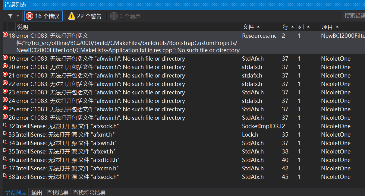

the errors you are getting in building the NicoletOne binary are expected, as this requires MFC support, which is only included in the professional version of Visual Studio. However, the remaining BCI2000 binaries should be build. To isolate the issue you please past the entire build log and a listing of your prog directory?

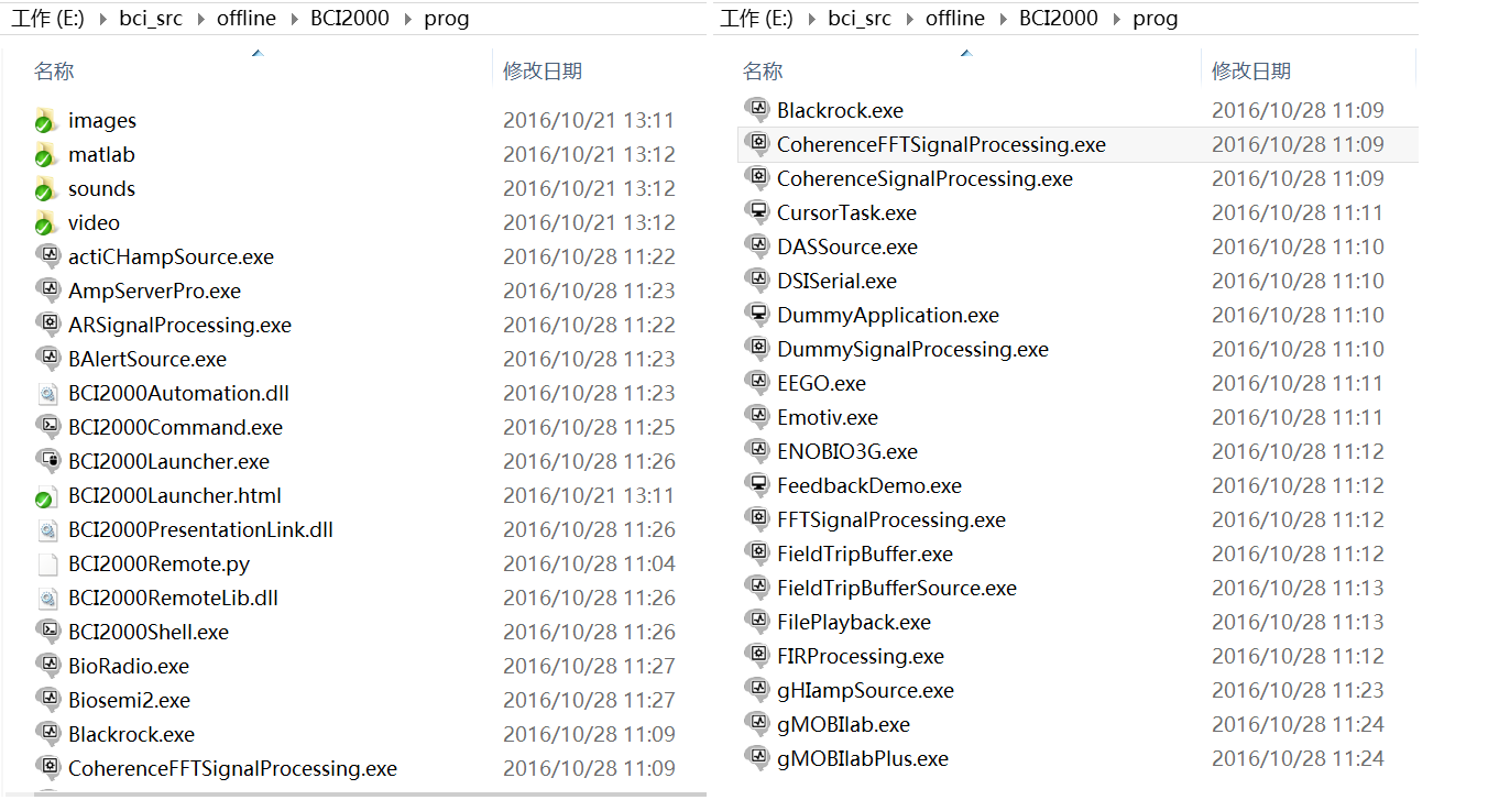

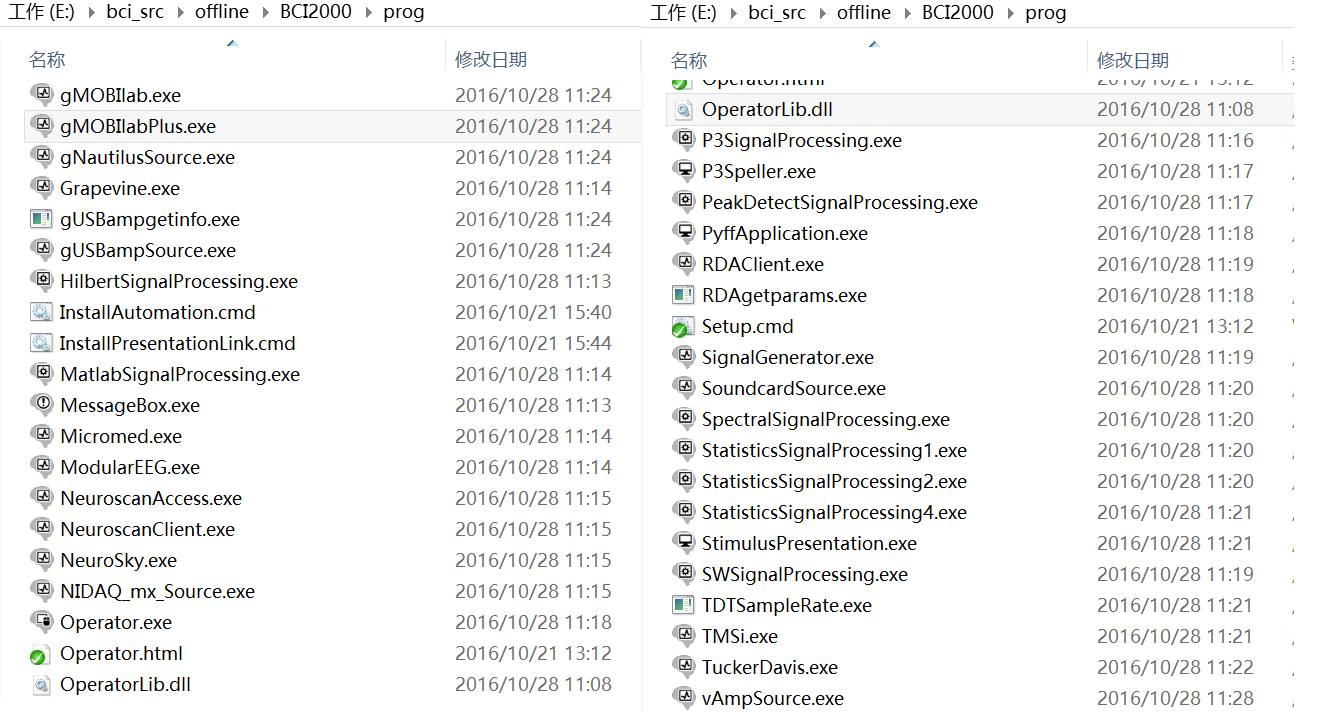

And the prog: Regards, JaneATY

Looking at your screenshots, I see that you have all the necessary modules build. You should be able to just click at the BCI2000Launcher and start BCI2000 in any necessary configuration. If you can describe what you want to accomplish, I can provide you with more detailed instructions.
the link to the output log does not work witout username and password.
