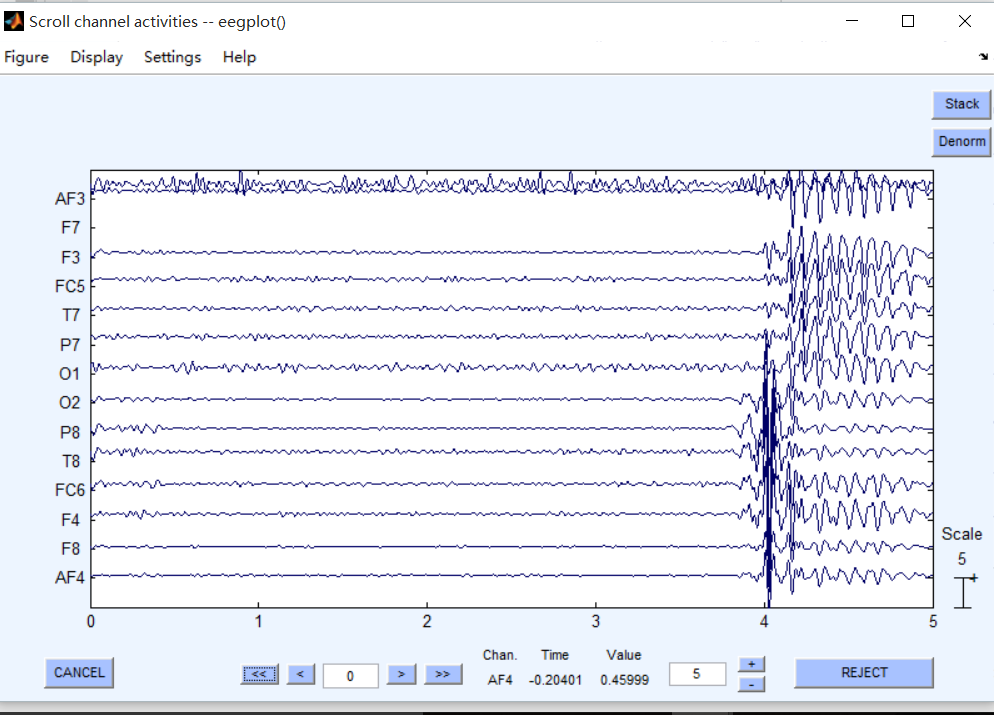

I am quite new to BCI2000, and I am having troubles with it. I obtained data from Emotiv Headset, where it has 14 channels. I simply clicked the mouse whenever there is a oscillation happens in the plot. Signal, stimulus, and channel names are stored in the workspace, then I saved the workspace (test.mat).

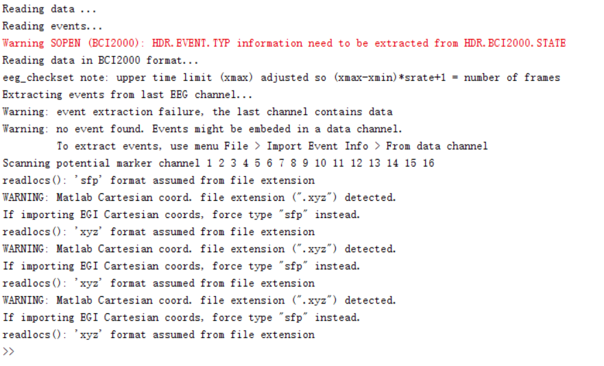

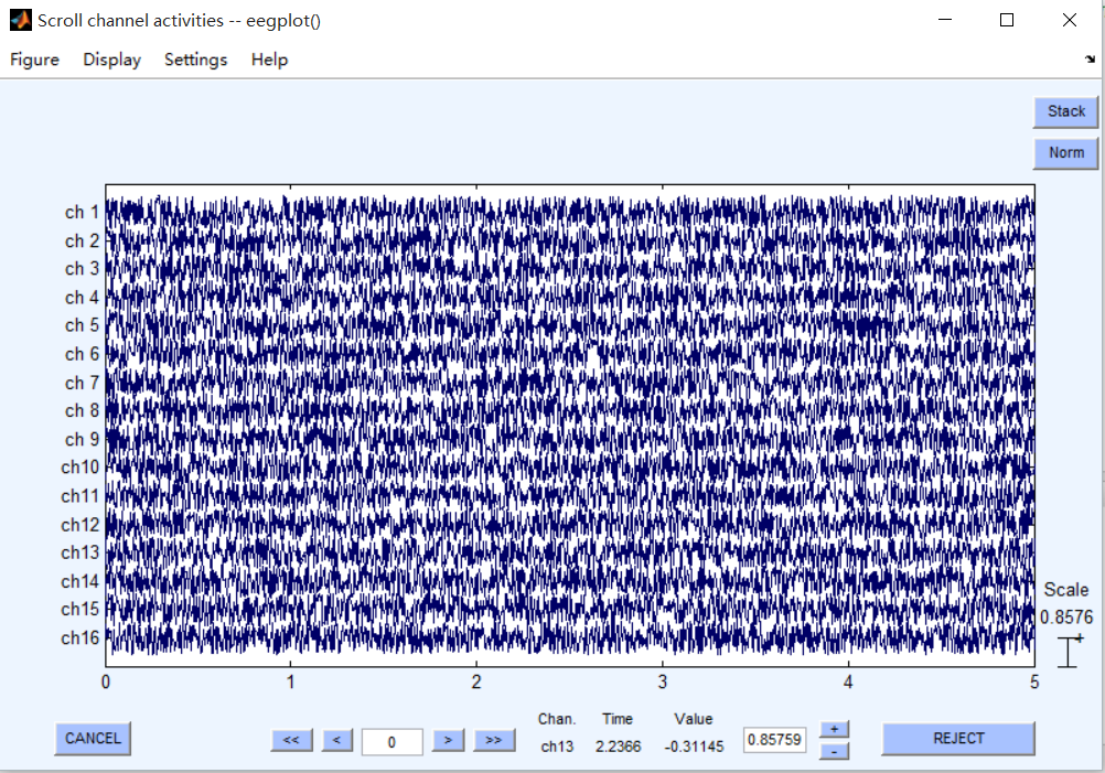

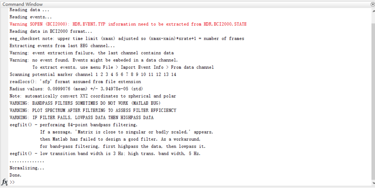

I then used save_bcidat ('try.dat', my_signal, my_states,my_parameters). and i obtained a .dat file. And here comes a problem, i was trying to use the bcilab function EEG= io_loadset('try.dat'), and EEG= exp_eval_optimized(EEG); and added a filter EEG= pop_eegfilt( EEG,8, 30); i obtained a plot with signal but no event has found.
How do I have the event marker shown in the plot?

Then I loaded the try.dat file using io_loadset, and still no events are shown.

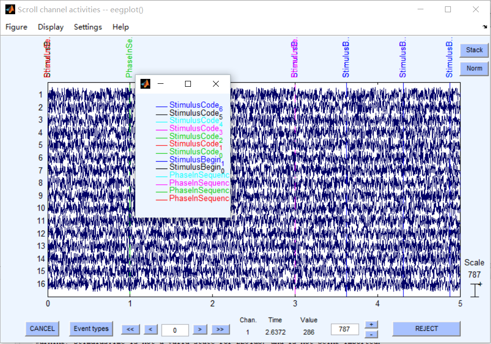

However, if I just load the io_loadset('D:\BCI2000\BCI2000\data\test001\testS001R02.dat') using io_loadset, there are events. Can someone help me with this ???
