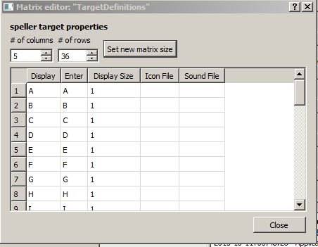

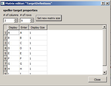

I've succeeded in building the current svn trunk BCI2000 with Visual studio 2012, for a better explanation I attach pictures of the different windows:
1)TargetDefinitions: here, the regular 6x6 targets for a speller, as we can see the Icon file column to input target images works well. 2)Target Definition 3x3: here I want to work with a 3x3 speller matrix, after changing the column and row number the colmun of Icon file disappear:
