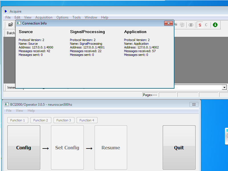

Situation changes when i try to run modified (in the original StimulusPresentation_SignalGenerator.bat NeuroscanClient was used instead of Signalgenerator and new parameter file [obtained by means of the neurogetparams Command Line Tool] instead of "../parms/examples/StimulusPresentation_SignalGenerator.prm") .bat-file.
It looks like the source module can't connect to the neuroscan acquire system (acquire 4.5 to be exact)
When operator module windows appears, its impossible to start application. If i press "set config" nothing happens for some time, then it becomes impossible to even press "set config" button
Log file is as follows:

2012-08-10T17:40:55 - Loaded parameter file "C:\bci\BCI2000\prog\../parms/500hz.prm"
2012-08-10T17:44:10 - Operator set configuration
Can anybody please help me ?
