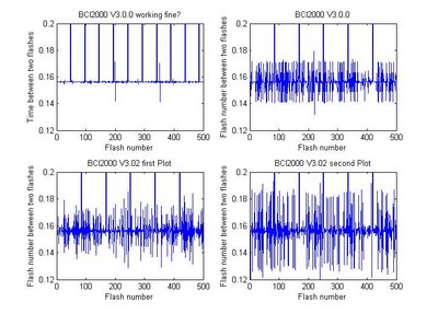

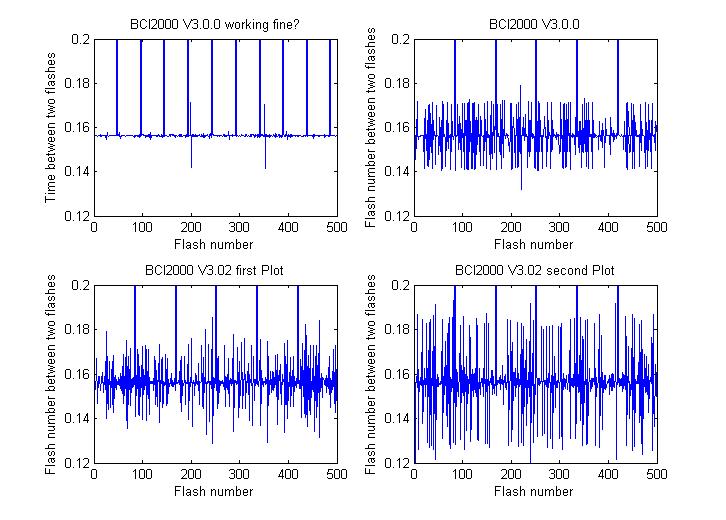

We did some more research.
Here we tested the two working versions.
I don't know why its working sometimes better (first plot of version 3.0.0) and sometimes not.
Might a notebook hard drive with 5400prm slow the system down?

How was this data collected? Were you using PrecisionTime or some other sort of software timer?
What was the difference between the first BCI2000 3.0 run (where it was "working fine") and the second?

we recorded those data by an external phyton script.
It is a bit courious, because the first record, was from the self written application and operator module. But i think, that is was an absolute hazard, that it worked fine. Like the timing is not allways that bad.
Moreover, we discovered, that the performance was in addiction of the CPU and harddisk speed.
Before we had those timing problems, we used an DELL notebook with Core i5 @ ca. 2.5gHz, 4gb ram and a 5400rpm hard disk.
Now we use a desktop computer with Corei5, 8gb ram (3.5gb used (x84)) and a 7200rpm hard disk.
With those new settings, the timing is perfect, and changes in a range lower than a milli second.
What i would suppose, is that writing the EEG and logfile data to the disk is causing the timing problems on slower disks.
