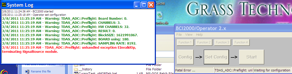

Third – push the Set Config button. Then the BCI2000 gives an error. Here is the system log and operator show us>
See attached screen-hardcopy file.

it appears you are using a modified version of the DAS source module, so it's difficult for me to help you fix that problem. The error message means that the source module crashed due to a programming error. The messages in the BCI2000 operator window show a suspiciously high value for "BlockSIZE", which might be related to the cause of the crash. Also, try with the unmodified DAS source module, and see what happens.
