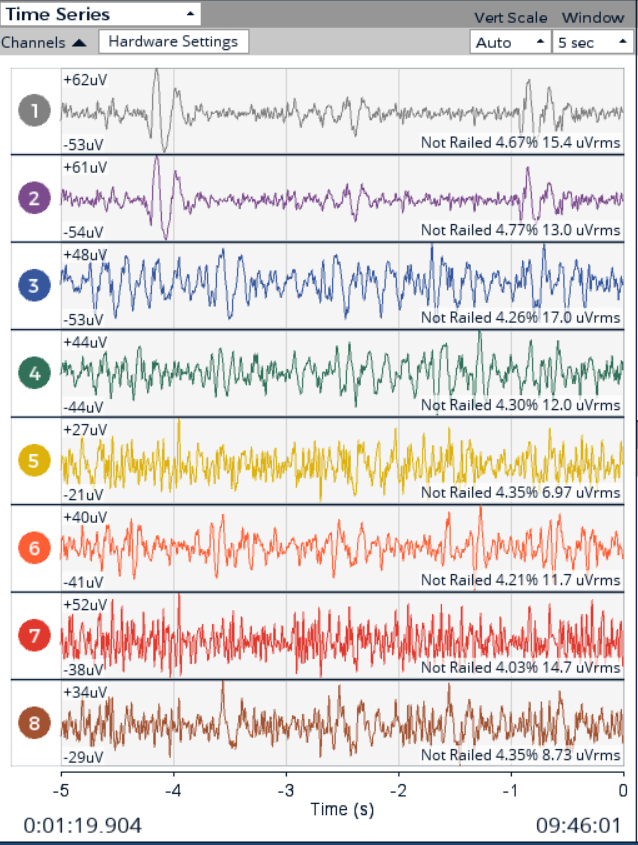

Swapped out the passive for the active electrodes this morning and connected to the OpenBCI app. Set the channel gains there to 1x and everything appears to be in order:

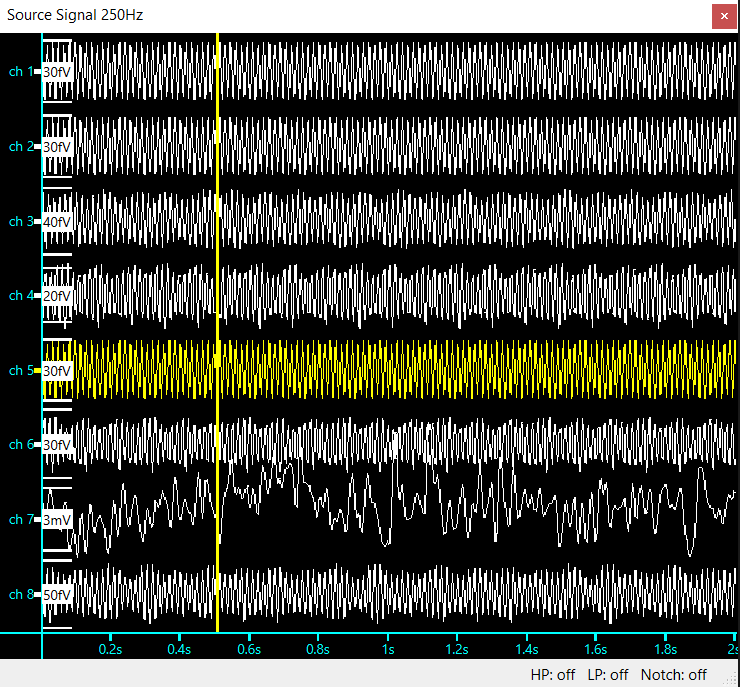

However, when I went to BCI2000, setting the channel gains to 1x, I'm seeing the following:
It doesn't seem as if the gains are still being set properly, though I am not sure why I'm getting fV when I'd expect the gain to be set to the default 24x, which should result in an increase in order of magnitude, not decrease. Strangely enough, when I set the gain back to 24x, I still receive the same readings.

Channel 7 shows a reasonable signal, so there doesn't seem to be a fundamental problem. The large range (mV) could be due to the amplification of the active electrodes (which BCI2000 does not know about).
The remaining signals could actually be very small and contain only line noise (the time series looks like it).
Regarding the scale of the remaining signals, I suspect that you have AutoScale on. Right-click the signal display to switch it off in the context menu. Then you should get the default scale corresponding to the channel gains that you specified.

Testing this morning revealed that a number of channels needed additional time to settle. Oddly enough, however, channels 1 and 2 remained seemingly dead, reporting values in the fV range and the rest reporting values in mV. Those are my Fp1 and Fp2 electrodes, so they should be among the most robust.
I tried your suggestion of toggling AutoScale, and that helps w/ visualization, but that doesn't address the core issues of these two channels appearing dead and the rest reporting these large values. There is something still amiss w/ how BCI2000 is settings the gains, since I get completely normal readings in the OpenBCI GUI after setting the channel gains to 1x there.
