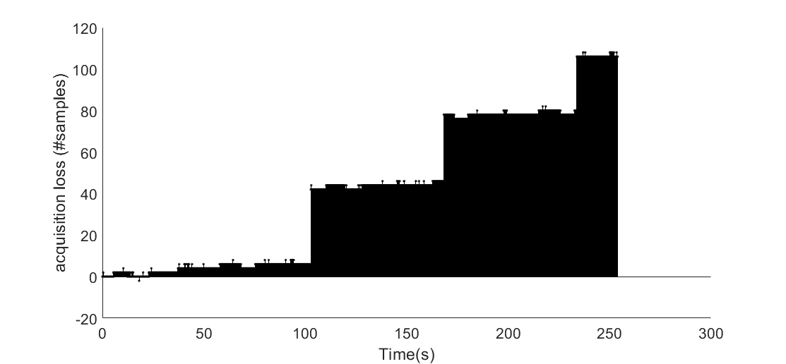

Jurgen, thanks for the explanation; that is all valuable info I will save to reference later. I did the calculation you recommended for my test file; I came up with a difference of 53ms. That is to say, the file has 53ms worth of data points more than we'd expect to see, based on the SourceTime state. That is a larger difference than I'd like. I took it one step further, and calculated the analogous difference *for each block of data*:
(actual #samples) - (expected #samples)
I'm calling this quantity the "Acquisition Loss". The (expected #samples) is SourceTime*(SamplingRate/1000) for that block, since SourceTime is a millisecond timer. Attached is a stem plot of the Acquisition Loss for my data file. The units of the y axis are #samples, as noted. The final difference at the end of the file is 106 samples (53 ms at 2kHz sampling), which agrees with the one-time calculation you recommended. I created this plot in the hopes of pinpointing the times when issues arise with the acquisition. From the plot, you can see my description from my earlier post: most of the plot is flat, with small jumps in both the positive and negative directions. There is little net change (we are off by 6 samples at 100s into the recording), then a sizeable jump of right around 1 sampleBlockSize, or 40 samples, occurring a little after 100s in. Something similar happens at around 168s, and a final time at about 234s.
When I first saw this, I thought perhaps the jumps in the plot could be used to identify the exact moment(s) when something problematic happened. Does this seem reasonable? I can think of one alternative explanation: that BCI2000 is getting "behind" the hardware buffer gradually, by a few samples here or there, and only when these "left behind" samples accumulate to something on the order of SampleBlockSize do they get pushed to the software during an "extra" read. Of course, if that was the explanation, then it wouldn't make very much sense that the Acquisition Loss value oscillates up and down by a few samples during nominal (e.g., flat) times in the plot.
I'd be interested to hear your thoughts.
Re: Understanding acquisition timing
Post by mellinger » 17 Apr 2024, 16:20
Wouldn't "excess acquisition" be better suited for this, or "acquisition loss" with sign reverted?
Yes, I agree with that. I don't think samples were hiding somewhere within BCI2000 :)
Upon your post, I took another look at the BlackrockADC source code. There are two things odd about it:
1) The aqcuisition thread is waiting in a polling loop until enough data is available, rather than waiting for a synchronizer,
2) within the polling loop, the data queue is accessed without holding a lock, and thus creating a race condition when reading/writing queue size.
1) will result in more timing noise than necessary, and 2) may result in more objects being popped off the queue than it contains (it's undefined behavior).
I'll commit a fix for 2) but cannot do any real development on the BlackrockADC because I don't have access to a Blackrock device.

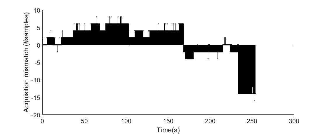

You're probably right about the name of my made-up quantity, should have called it acquisition gain or some such. More importantly, you have it right about the interpretation: positive deflections indicate that the software is somehow getting "extra" data, possible examples of the behavior you put in your point (2). Negative jumps, of course, would indicate unexpected delay.
In thinking about how to deal with this, and hopefully rehabilitate this data for further analysis: the first thing that comes to mind is to try simply eliminating the "extra" blocks of data. This has a soothing effect on the acquisition mismatch quantity (attached), ending up with a less-alarming 14 sample mismatch at the end of the data (7 ms). However, I'm not confident this is valid, and applying it to the actual signal array will be tricky due to the possibility of creating transients.
Post by mellinger » 18 Apr 2024, 06:29
I rather think there should be transients in the original signal, and properly restoring it will remove those transients. Often, transients show up prominently in the signal's time derivative (i.e., diff) because the signal is typically low-pass filtered before being digitized.
