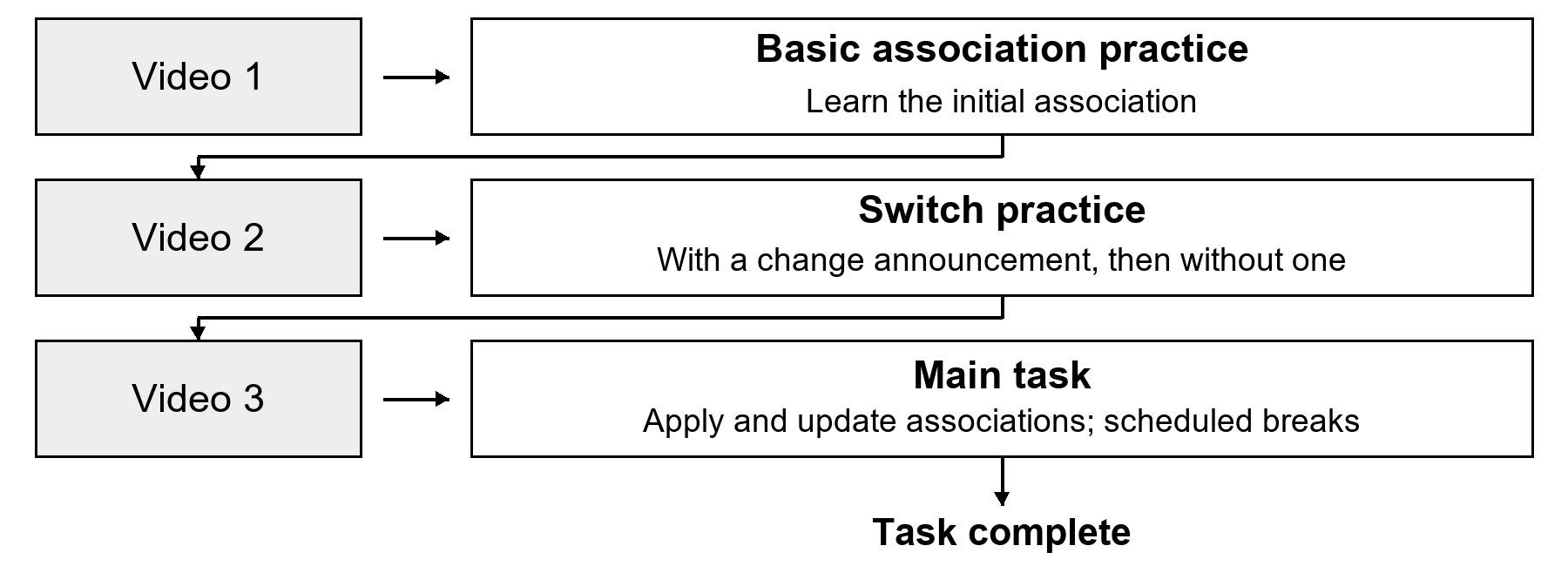

Guided session in order: Video 1 then basic association practice; Video 2 then switch practice with an announcement and then without one; Video 3 then the main task with scheduled breaks, followed by completion.
Figure 1. Guided session flow. Basic practice can be repeated. In the main task, association changes are not announced.
An on-screen association hint supports the start of unannounced practice and the main task, then fades. Participants continue using feedback to guide their choices.

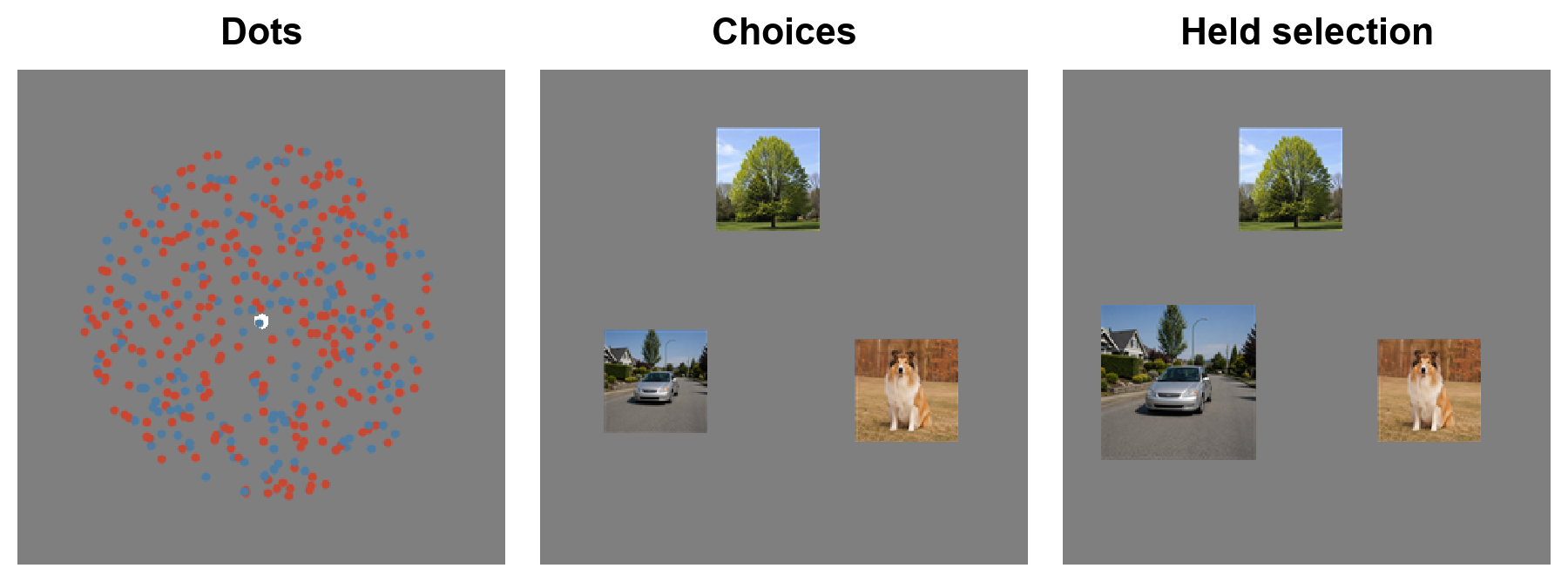

Three equal central crops from the same trial: a red-majority dot cloud, three category choices, and an enlarged car image while the left response is held.
Figure 3. Enlarged views from one trial, using identical central crop bounds and magnification. Dots disappear before choices appear. Holding a response key enlarges that image; no elements have been repositioned.
Display settings in the documented configuration: 452 dots; red RGB [199, 72, 50], blue RGB [77, 123, 161]. ImageSizePixels = 70 and SelectedImageScale = 1.5 give a 70-pixel base image and a 105-pixel selected image. Source-image resolution is separate from on-screen size.

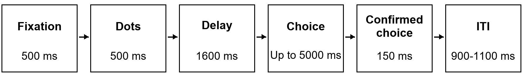

Trial order and requested timings: fixation 500 ms; moving dots 500 ms; delay 1600 ms; choice up to 5000 ms; confirmed choice 150 ms; intertrial interval 900 to 1100 ms. A 100 ms response hold occurs inside the choice window.
Figure 4. Single-trial sequence and requested timings for the listed configuration; boxes are not to time scale. The 100 ms key hold occurs within the choice window.
The fixation marker remains during the delay. With the listed settings, a confirmed choice stays visible for 150 ms, followed by the intertrial interval (ITI). Correct and incorrect responses request distinct feedback sounds at ITI entry; a timeout skips confirmation and receives no feedback sound.
