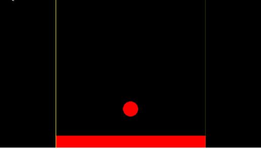

We have run a few experiments and we have a few more questions. These are related to the original Mu Rhythm Feedback Task:
1) In the case of Mu, how exactly does the ball move? Is it the higher the Mu power, the ball moves more vertically upwards? If the ball moves up, does that mean that the power of the frequency used increases? And if the ball moves downward, does this mean that the power of the frequency used decreases? I am talking about this in the case of the basket task (See attached photo for example). If one wants to increase Theta power, could we just have a program where the ball just moves upwards to a target from the bottom of the screen, assuming downwards movement means a decrease in theta power? In summary, I am unclear on how the power extracted from a frequency band actually gets translated to movement. I understand from the documentation that when the bar is down, that means the subject must perform motor imagery and if the bar is up the subject must rest. How does that relate to our case of trying to increase theta? Does this mean we must have a task that increases theta (Compared to rest) to use BCI2000?
2) Is there a way to prevent noisy electrode(s) from being used in CAR? For example, if O2, F1, Pz are noisy, is there a way to not let them be included in CAR?
Finally, the task that is present in the documentation is different than the one titled "Mu Rhythm Feedback.prm" provided in the .prm in BCI2000. I am not sure if you are aware of this.
I looked at the documentation for answers and these questions were still unresolved which is why I am asking them here. I hope I am not being rude in any way in asking these questions, as simple as they are.

Re: A Theta Power Band Controlled 1D Cursor Task-Parameter Questions
Post by mellinger » 27 Feb 2020, 11:08
As you suggest, movement upward means a more-than-average amplitude of the mu rhythm at the selected electrode and frequency.
If you want to increase theta power, you cannot use the mu rhythm feedback setup because it will suggest increase as much as decrease, swinging around a mean value in order to transfer information, which is the purpose of a BCI.
However, you can configure the CursorTask to display only a single target at the top by setting the NumberTargets parameter to 1.
After normalization, the power is taken to be the vertical speed of the cursor. The Normalizer removes the mean, so above-average power will move the cursor upward, below-average power will move it downward, provided the sign of the normalizer gain is positive. If it is negative, direction will be reversed.
If you want to use BCI2000's mu rhythm task as a BCI, you will need a modulation of the brain signal that can be achieved voluntarily by the subject. If you want to control BCI2000 by theta, you need to provide the subject with two different instructions, one to increase theta, one to decrease theta. The increase needs only to be relative, so one of the instructions may be "rest".
If you don't want to use BCI2000's mu rhythm task as a BCI but only to provide feedback about the subject's current theta activity, then set the NumberTargets parameter to 1 and switch off adaptation as described above.
Specify the electrodes you want to keep in the TransmitChList parameter.
This is an obsolete parameter file, I don't think it was mentioned in the documentation. Thanks anyway.

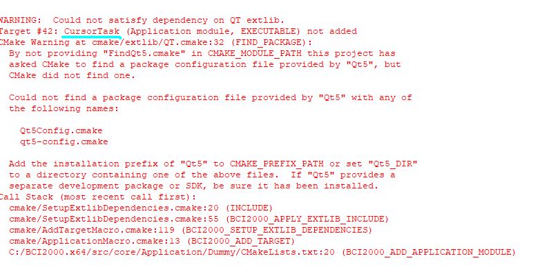

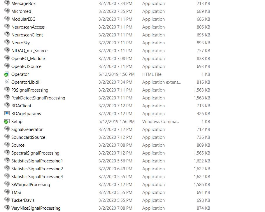

After pressing SVN update at least 50 times, we are still not getting Cursor task (See attachment below).
It turns out all of our .exe files were from 2012 so I want to use the most recent version of Cursor task and the other modules if it matters. Is there another way to get the most recent file of BCI2000 without having to compile and go through CMake? Could you perhaps send the most updated file of BCI2000 directly with all the executables?
I will keep trying SVN update, but I would appreciate any other advice you have. All of our files were from 2012, so getting the most recent version of BCI2000 will really help.
However, we did find the Basket task.prm file, so thank you for your direction. If we can just get the rest of the most updated software we should be good.
Thank you! Once more, I really appreciate your replies.
Mohammad Hadji
Post by mellinger » 02 Mar 2020, 06:21
Your screenshot does not show a CMake error but a CMake warning. The instructions tell you to install Qt and to define a CMake variable Qt5_DIR that points to your Qt installation. If this is done correctly, as described in the instructions, CMake will recognize Qt, and CursorTask will be built.
