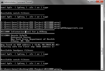

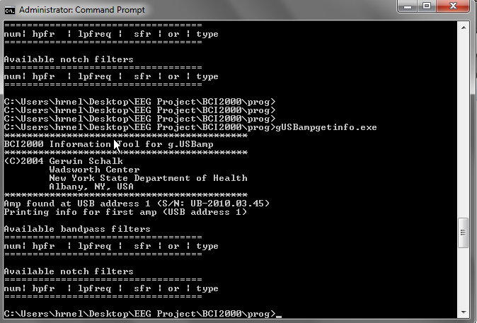

I am attempting to interface the BCI2000 software with my gUSBamp amplifier.
I have a windows 7 64bit machine
My usbamp is a UB model v3.0
I have the 3.0 driver installed and the 3.0 DLL on (and tried it off) in bci2000/progs/
I have been successful when opening the gUSBamp demo. I was able to "open" and "start" the amp and see an EEG signal responsive to change. So I know my setup is working this far.
When I attempt to open the BCI2000Launcher with the gUSBampSource I get the following error:
DataIOFilter::Preflight: gUSBampADC::Preflight: Could not find appropriate notch filter in gUSBamp. Use gUSBampgetinfo tool.
When I run the gUSampgetinfo.exe I get no available bandpass or notch filters (attached picture).
What do you think is going on?
