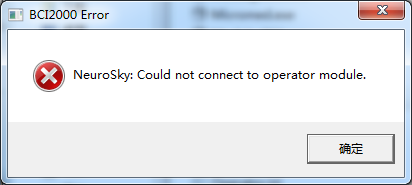

The following Steps:
1. Launched the BCI2000Launcher.exe, select Neurosky, P3SingleProcessing, P3speller.
2. Config, set the right Com, add the P3Speller_CopySpelling.prm. (I'm quite sure I've set the right COM Port.)
3. Set config, it halted with the error in the first atstachment.
And the system log says:
2016-10-17T15:43:06 - SignalSource error, DataIOFilter::Halt: NeuroSkyADC::Halt:
64-bit Library "thinkgear" could not be loaded

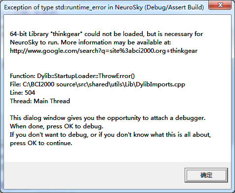

If I launch the NeuroSky.exe it will prompt the error like attachment 2.
Can anyone can provide me some information about this, thanks.

Re: SignalSource error, NeuroSkyADC::Halt: 64-bit Library "thinkgear" could not be
Post by pbrunner » 19 Oct 2016, 18:39
Joycejin,
you wil need to use the 32-bit version of BCI2000, as there is no 32-bit version of the thinkgear.dll.
Let me know if this resolves the issues.
