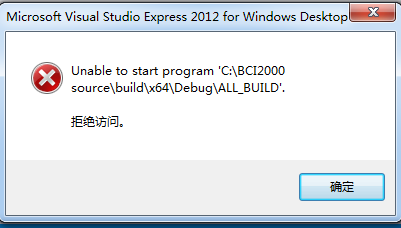

Hi Peter,
I updated to the latest version, but still prompt the similar error below:
Error 11 error C1083: Cannot open source file: 'C:\BCI2000 source\build\build\buildutils\BootstrapCustomProjects\templates\TemplateFilter.h.in.res.cpp': Permission denied C:\BCI2000 source\build\CMakeFiles\buildutils\BootstrapCustomProjects\c1xx NewBCI2000FilterTool
After second run, it will prompt the unable to start program error like the attachment.
Joyce Jin
Joyce Jin
