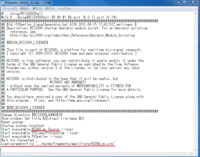

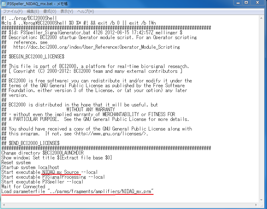

Tinui,
you have two options:
1) Copy the P3Speller_SignalGenerator.bat into a new P3Speller_NIDAQ_mx.bat and replace the SignalGenerator.exe in the batch file with the NIDAQ_mx_Source.exe. After starting this batch file you then still need to configure the source tab accordingly and save the resulting parameter as a new parameter file. Edit the batch file again and replace the last loaded parameter file with the new one.
2) Use the BCI2000Launcher.exe and select the NIDAQ_mx_Source.exe as the signal source, the P3SignalProcessing for the signal processing and the P3Speller for the application. Load the parameters from the parms folder for the P300 Speller and configure your source tab. Save these settings into a new parameter file.

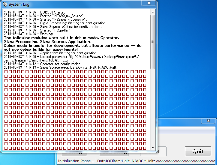

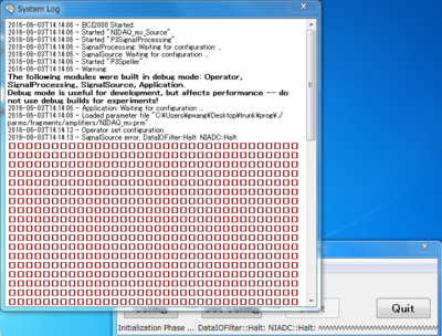

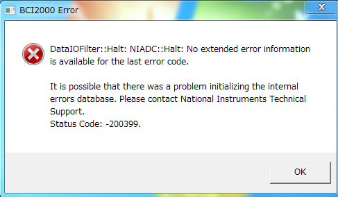

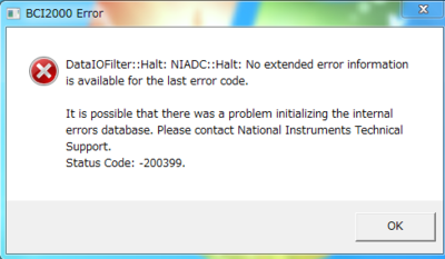

But, when I executed "Set Config" after all of the procedure has been completed,
the following error(Fig1.png) came out. And when I executed "Quit", the following error(Fig2.png) came out.
I ran also (2) procedure, but the same error came out.
Is batch file that I have edited is correct?(Fig3.png :red line)
If it is correct, could you tell me the solution?
Best regards, tinui

please check whether you have NI DAQMX 8.5 installed.
This source module was developed under NIDAQmx NI DAQMX 8.5 and you might need to install that specific version for it to work.
Please see the release notes [1] for the list of compatible devices in version 8.5.
[1] http://www.ni.com/download/ni-daqmx-8.5/276/en/
