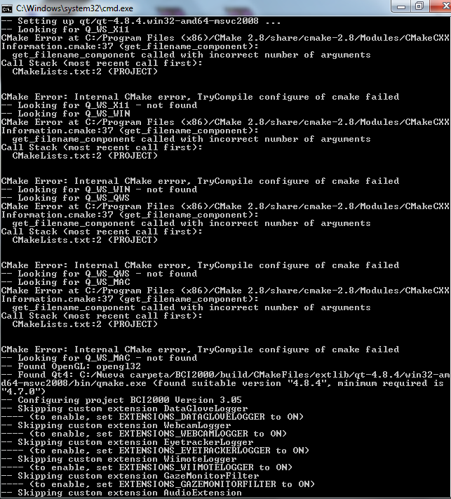

Hi, i´m stuck with the same problem :(.... I updated the 2 foldersthat Mehmet Günal said and it seems that was working because it started to load all the complements but suddenly return "configuration incomplete, errors occurred".
I saw the cmd window and the error seems to be some problem with a library...
Can someone give me a hand?...

Post by mellinger » 12 Sep 2013, 12:14
make sure to install all available VS2010 service packs (SP 1 at least), and update your CMake to the latest version.
