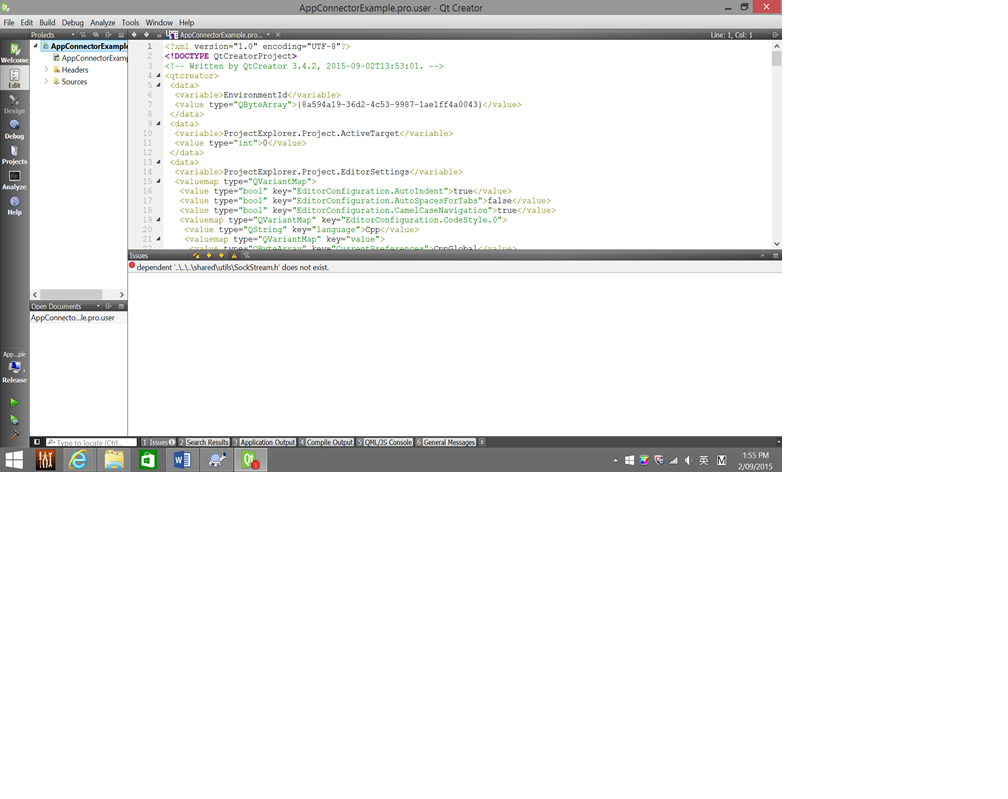

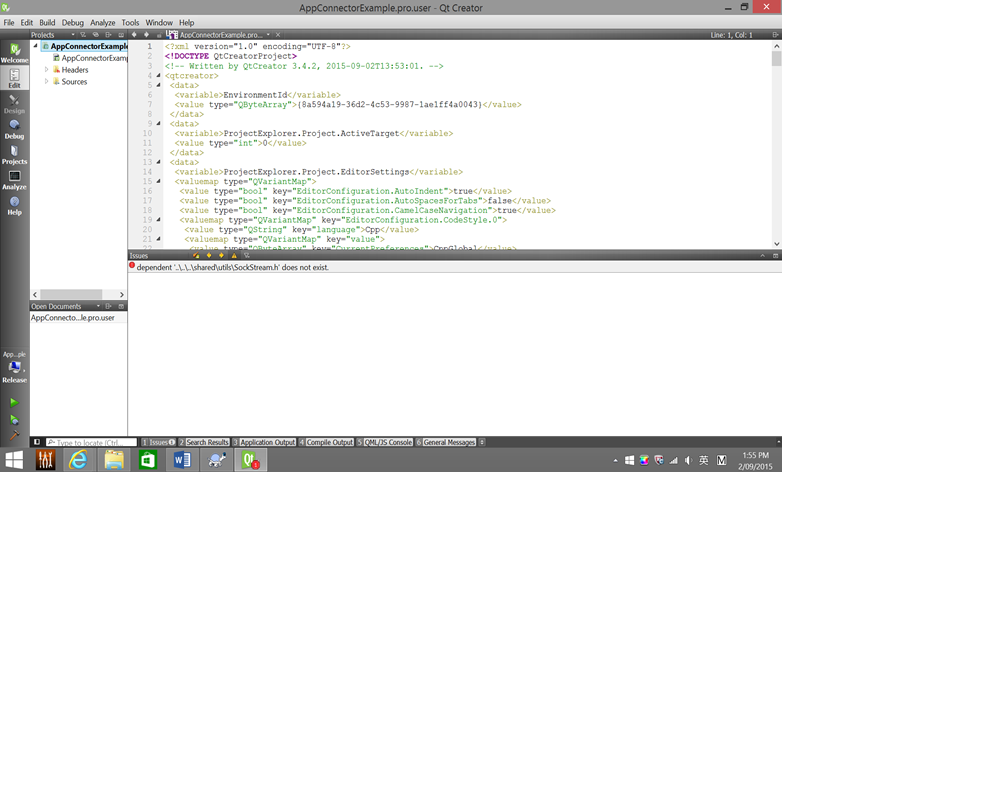

i have update my bci2000 to the latest revision in Svn #4993 ,but still show the same issues and i really want to upload the picture of my Qt interface ,but when i add the attachment the website will jump to a blank website and wrote this can nor be dispaly
ps: i just open the AppConnectorExample.pro in the Qt and run it and i did not doing any change in the AppConnectorExample.pro is it right?
summersun
Posts: 14
Joined: 04 May 2015, 21:56
Re: the question about connecting the bci2000 to the ardunio
Post by summersun » 02 Sep 2015, 00:50
hi phrunner , this is my attachment
Posts: 344
Joined: 17 Sep 2010, 12:43
Post by pbrunner » 02 Sep 2015, 11:01
Summersun,
I do not see the error message in your screenshot. To build the AppConnectorExample.exe you have two options:
(1) Using your own Qt5 installation and Qt Creator: First make sure that you delete any previously created "build-AppConnectorExample-Desktop*" folder. Then open the AppConnectorExample.pro file in Qt Creator and press "Configure Project". Then hit the green play button to compile and start the AppConnectorExample.
(2) Using the BCI2000 Qt installation and MS Visual Studio 2012: Install MS Visual Studio 2012 and install all updates up to SP4. Install CMake and make sure that it is in your system path variable. Delete any previously created "CMakeCache.txt" file in the build directory. Start the "Make VS2012 Project Files.cmd" and select your compiler version (professional or express) and select which components of BCI2000 you would like to build. After a new "CMakeCache.txt" has been created, refine your selections by starting the "Configure.sh.cmd" file which opens up the CMake GUI. There check the "BUILD_DEMOS" options and press "Configure" and then "Generate". Open the newly written "BCI2000.sln" file and compile the project. You should now have a AppConnectorExample.exe in the "\src\contrib\AppConnectorApplications\AppConnectorExample" folder.
Please note that you might run into issues if you have other versions of the MS Visual Studio compiler installed. In this case, uninstall these versions.
