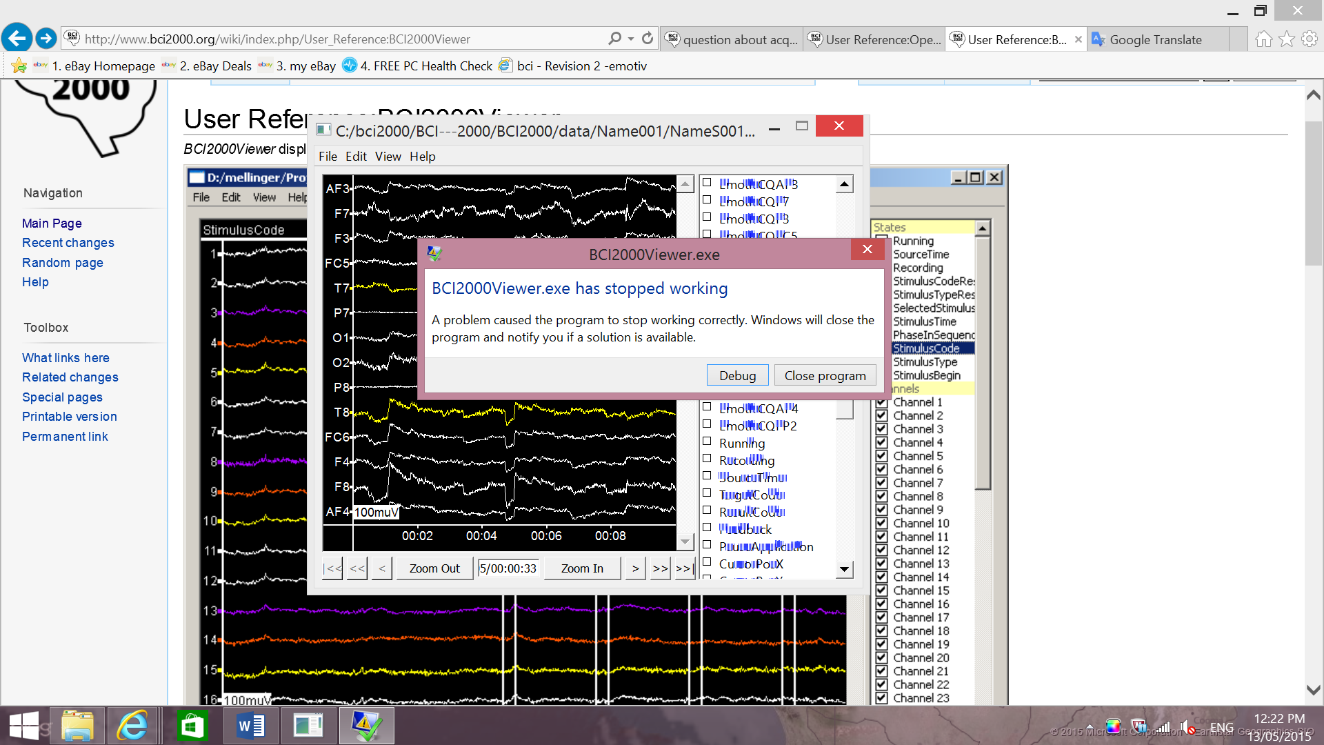

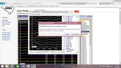

Re: question about acquire EEG signal in bci2000
hello peter
when I view my EEG data in BCI2000Viewer and mark the state checkbox in the right side of bci viewer,
the BCI2000Viewer always stop working, as shown in the attachment.
best regards ,summer
Summersun,
I can look into this issue, however I would need the following info from you:
(1) Which version of BCI2000 are you using, i.e., binary download or self compiled. If self compiled which SVN version and which compiler.
(2) Which operating system are you running BCI2000 on.
(3) Please upload the binary of the BCI2000Viewer and the BCI2000 data file that causes the viewer to crash.

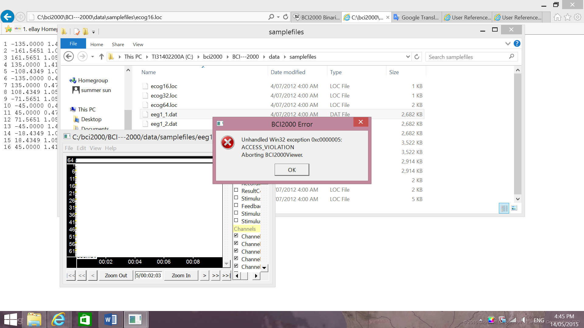

hello peter
(1) the version of bci: file version 9.20.0.0
(2)operating system windows 8.1 ,64bits
(3)when I upload the binary of the BCI2000Viewer and the file that causes the viewer to crash, the system show: size is too large and the extension dat is not allowed , separately ,the BCI2000 data file I run in BCI2000Viewer is the EEG signal that I acquire from Emotiv neuroheadset, but even I run
samplefiles of bci2000, the BCI2000Viewer still not working.
the attachment is the new picture when I run BCI2000Viewer,as shown in the picture ,is it the BCIViewer only support for 32bits?
Thank you
Thank you

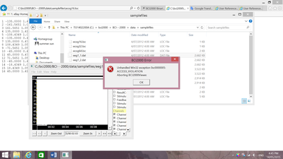

Summersun,
I could not reproduce your error. Can you please try to download an updated version of the BCI2000FileViewer from the link below:
http://tinyurl.com/mkwekld
Please report back if this resolves your issue. If not please upload the BCI2000FileViewer and the datafile to your google drive, dropbox or a similar location from where I can download it.
Hi every one!
I had had the same problem, but luckily using the pbrunner's link, BCI200Viewer works fine.
Thank you so much!
Thank you so much!
pbrunner wrote:Summersun,
