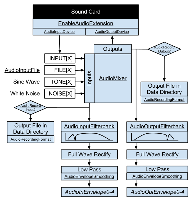

Experiments which require audio input or real-time audio synthesis based on system state are now possible with the AudioExtension. This extension is capable of recording multiple channels of audio input, synthesizing tones or noise, and reading encoded audio files. These channels are input to a mixing matrix which mixes those inputs to multiple channels of audio output. Both input and output are run through a simple filterbank, then they have their envelope extracted and logged into states via the bcievent interface. Audio input and output channels can be recorded into audio files losslessly and can be resynchronized offline. The mixing matrix is a matrix of expressions which can be used to dynamically change audio mixing based on the system state.

Block Diagram
Parameters
