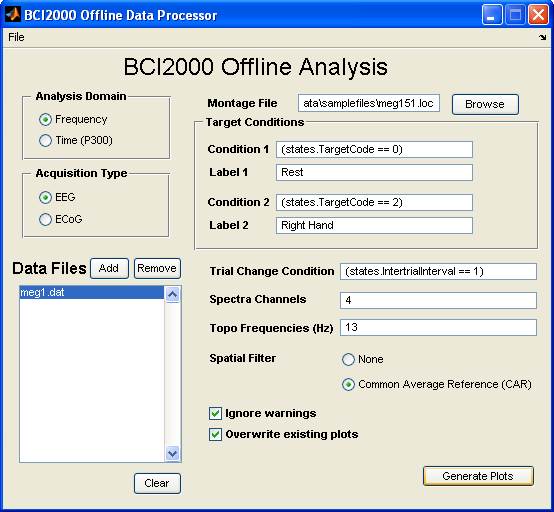

  1. Open BCI2000 Offline Analysis. If this is your first time using BCI2000 Offline Analysis, you may want to review the instructions on how to install and run this application: User Reference:BCI2000 Offline Analysis.
  2. Click the "Add" button next to "Data Files" and navigate to data/samplefiles/. From there, select the file meg1_1.dat and click "Open". If this file isn't present, please download the supplementary sample files and extract them to data/samplefiles/.
  3. Click File>Load Settings
  4. Navigate to data/samplefiles/
  5. Double-click or otherwise open meg1Analysis.bws
Now, click "Generate Plots". At this point you will be presented with a message dialog warning you that the number of trials found using the selected datafile is less than 10. In order to sufficiently generalize the response, it is recommended that your data (i.e., all selected datafiles together) comprise at least 10 trials. In some cases, you will not be able to meet the suggested minimum. In that case, you can mark the checkbox labeled "Ignore Warnings" to proceed. Even with this box checked, however, BCI2000 Offline Analysis will halt any analysis where the data comprises less than 3 trials. So, in order to proceed with this single data file, please check the box labeled "Ignore Warnings". Now the BCI2000 Offline Analysis window should look like this:

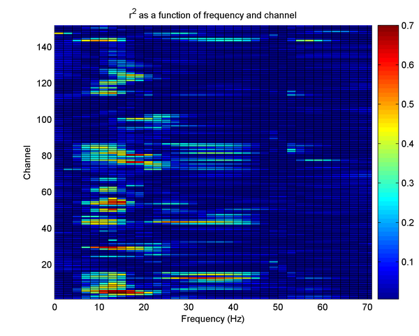

Click "Generate Plots" once again. Once your analysis is complete, you should see feature, spectra and topography plots similar to those below:

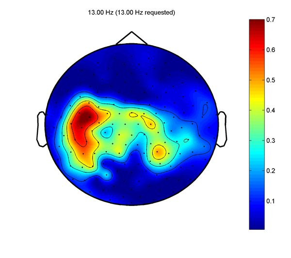

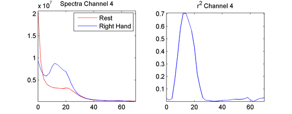

In designing this analysis, we followed a similar procedure to the procedure outlined in User Tutorial:Performing an Offline Analysis of EEG Data. We begin by looking for clusters of high r-squared values. Again, these clusters are typically the first indication that the frequency/channel pairs that comprise the cluster may be good features for on-line analysis. In the generated feature plot, one such cluster is centered around (13 Hz, Channel 4). So, we continue by creating a topography at 13 Hz and a spectra for channel 4. As in previous tutorials, we use these plots to evaluate the physiological plausibility of this response. First note that there are significant changes in the spectra between movement and rest. Also, the most significant of these changes occurs around the mu and beta frequency ranges. From the topography, we see that the response is largely present over the motor cortex of the left hemisphere. Such a response should be expected since the movement occurred on the right side of the body. Therefore, we conclude that (13 Hz, Channel 4) will likely be an effective feature for online control tasks.
