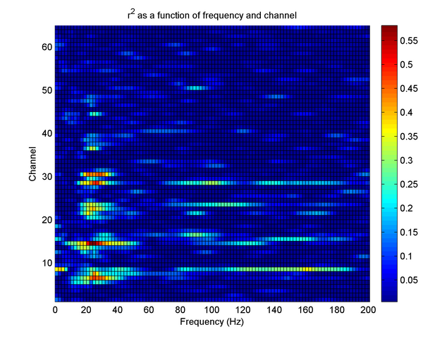

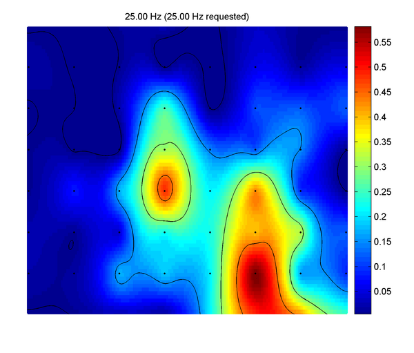

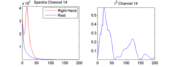

Now, click "Generate Plots". Once your analysis is complete, you will see feature, spectra and topography plots similar to those below:
In designing this analysis, we followed a similar procedure to the procedure outlined in User Tutorial:Performing an Offline Analysis of EEG Data. We begin by looking for clusters of high r-squared values. Again, these clusters are typically the first indication that the frequency/channel pairs that comprise the cluster may be good features for online analysis. In the generated feature plot, we see that one of the clusters with the highest r-squared values is centered around (25 Hz, Channel 14). So, we continue by creating a topography at 25 Hz and a spectra for channel 14. In the previous tutorial, we used these plots to evaluate the physiological plausibility of this response. We first note that there are significant changes in the spectra between movement and rest. Also, the most significant of these changes occur around the beta frequency range. When inspecting the topographies resulting from the EEG-based analysis, we were able to relate the spatial response to areas of the motor cortex known to control the muscle being moved. We can do this in ECoG as well. In this case, however, the location of an electrode will differ based on where the grid was placed. We must also be aware that an ECoG grid is subject to shifts in position over time. Because the above response is related to movement of the right hand, we expect the response to appear over the motor cortex of the left-hemisphere. There are, however, many reasons why this may not be the case. One simple reason is that the subject may not be performing the requested instruction. Regardless, it is reasonable to conclude from our analysis that (25 Hz, Channel 14) may be an effective feature for use in an on-line recognition task.
