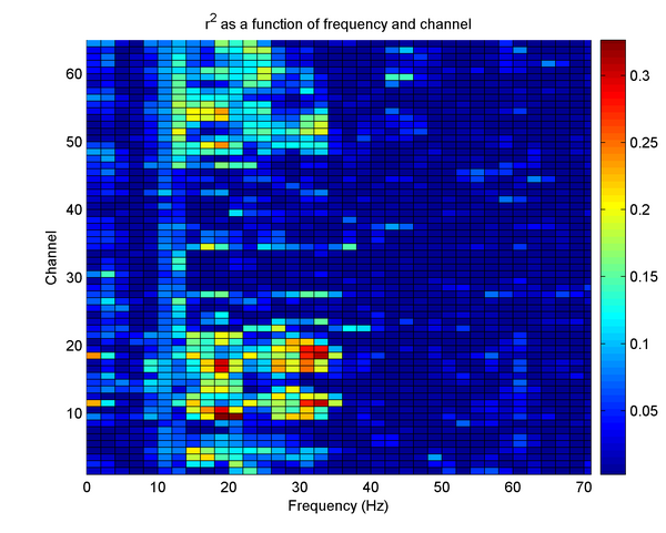

Once the analysis is complete, you will see a feature plot similar to the one below. This plot displays the r-squared values between the two distributions (i.e., the average signal for condition 1 and the average signal for condition 2) as a function of frequency and channel.
The feature plot provides an overview of the data. Thus, it is typically the best place to start your analysis. Using this plot, we can find potential features simply by looking for clusters of high r-squared values. In the generated feature plot, we notice some clusters centered around (31 Hz, Channel 18), (31 Hz, Channel 10), (19 Hz, Channel 10) and (19 Hz, Channel 16). To estimate the effectiveness of these features, we will need to look at them in more detail.

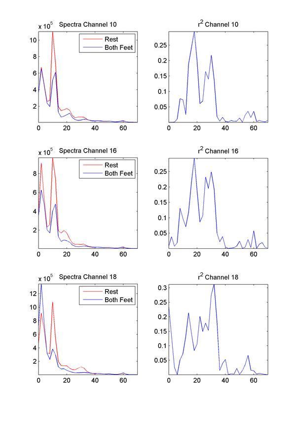

    2. Spectra Channels: In the previous section we found - by inspection of the feature plot - three channels that show considerable promise: 10, 16 and 18. To generate spectra for these channels, enter "10 16 18" into this field.
    3. Topo Frequencies: In the previous section we found - by inspection of the feature plot - two frequencies that show considerable promise: 19 and 31 Hz. To generate topographies for these frequencies, enter "19 31" into this field.
  2. Click "Generate Plots".
Once the analysis is complete, you will see the same feature plot as was generated in the previous section. Additionally, you will see a spectra plot and topographies similar to the ones below. In the spectra, we notice significant changes in spectral power at frequencies in the mu and beta ranges. Typically we expect less power at these frequencies during activity than when at rest as is these case in the generated spectra. The spectra for channels 16 and 18 also show significant differences in the lower frequencies (i.e., below the mu frequencies). Fluctuations at these frequencies have not been shown typically to be correlated to motor responses and are likely due to noise. Thus, we will want to avoid using these frequencies as possible feature candidates. As a note, it is often the case that one potential feature appears to be the harmonic of another. Take for example the case where one feature appeared at 11 Hz and the other at 22Hz. If, in this case, one feature were a harmonic of the other, the two would be highly correlated and there would likely be little to no benefit of using both features as opposed to just one. Very often, however, in the cases where there appears to be a harmonic relationship between two features, the features are very spatially dissimilar. In this case, the two features may not have such a high correlation and may both be useful for online classification.
The frequencies targeted in our analysis do not exhibit a harmonic relationship. Thus, it is likely the two are not highly correlated. The topographies below provide further evidence towards that assumption; notice the dissimilar spatial distributions for the two different frequencies. The topographies are also useful for evaluating the how physiologically plausible the recorded responses are. For instance, in the topographies below, the spatial distribution agrees with the expected spatial response for feet movement. See the User Tutorial:Introduction to the Mu Rhythm for more information about the physical properties of mu rhythms.
