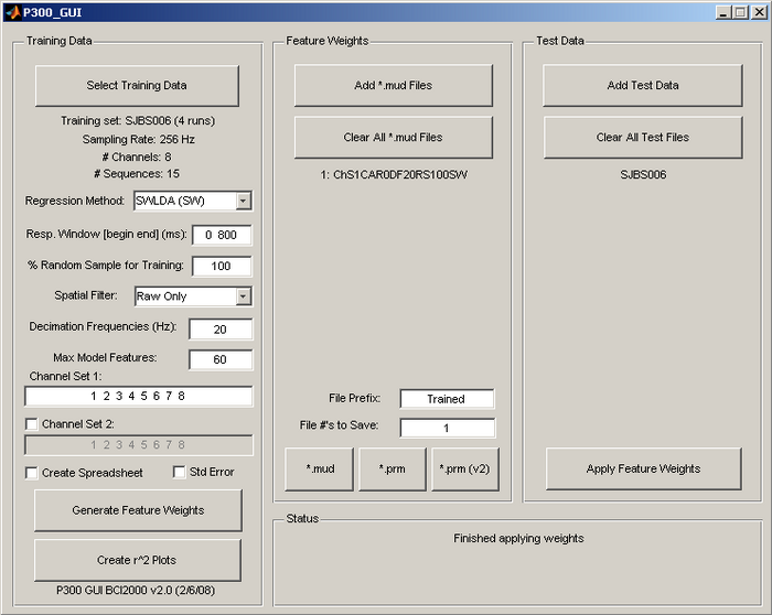

  • A GUI such as the one to the right will appear
  • In the upper left-hand column, click on Select Training Data
  • Select the data files collected from the runs for THE, QUICK, BROWN, and FOX
  • In the lower left-hand column, press the Generate Feature Weights button

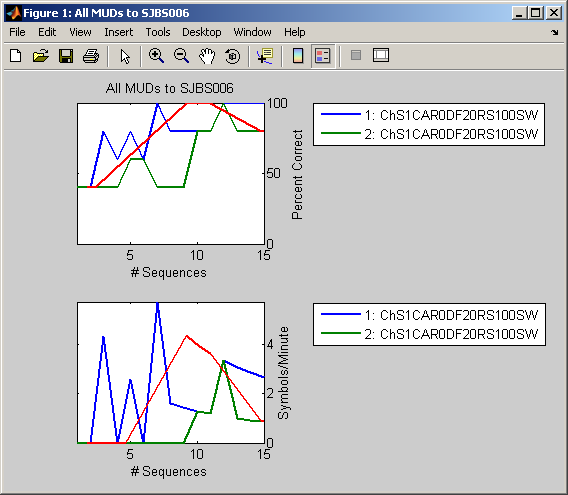

  • A pair of graphs should be displayed, similar to those below.
    • The important feature is to notice that the red line in the upper graph, the accuracy, increases with more flashes
  • Close the window of the graphs
  • In the lower-middle column, type Training for File Prefix:, and 1 for File #s to Save
  • Click on *.prm (v2)
    • This will generate a .prm (parameter) file in the same folder as the data files

  • Once the last run of data has finished, go back to the P300_GUI program and click Add Test Data in the upper right-hand column
  • Select the newest set of data, and click Apply Feature Weights in the lower right-hand column - A new window of graphs will appear
  • The important thing to see from these graphs is where the red line in the upper graph reaches 100%.
    • In the example below, this is from 9 to 11, and then drops. This means that 10 flashes gives the best accuracy.
  • If this does not give an acceptable level of accuracy, (typically 95% or higher), repeat more test runs to collect more data files. Add these data files as above, and click Apply Feature Weights in the lower right-hand column to look for how many flashes is needed. Repeat as necessary.
