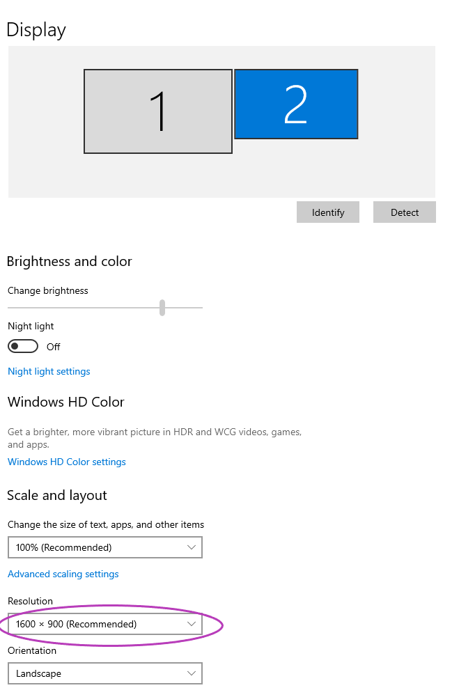

To begin, you first need to gather some system data. This tutorial will assume that you will be using a dual-monitor setup as shown below, with the experimenter of the sessions operating on monitor 1, and the subject will be watching monitor 2.
Open Display Properties by right-clicking on an empty portion of the desktop and clicking Properties, and navigating to the Settings tab.
Make sure that Monitor 2, (which displays the instructions to the subject), is on the right of Monitor 1, (the experimenter's screen), and is aligned along the top.
What we need to make a note of is the width of monitor 1, and the width and height of monitor 2.
In this example we see that Monitor 1 is 2048 pixels wide, and monitor 2 is 1024 pixels wide by 768 pixels tall.

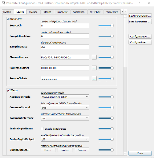

In the Source tab, set:
  • ChannelNames to the electrode positions according to the 10-20 convention.
    • This names the channels according to their respective electrode positions.
    • In our example, F3 F4 T7 C3 Cz C4 T8 Pz has been entered.
  • TransmitChList to the channel names entered into the ChannelNames parameter
  • If using a gMOBIlab amplifier, set COM port to the port name that you found earlier.
    • In this example, we would put in COM8:
