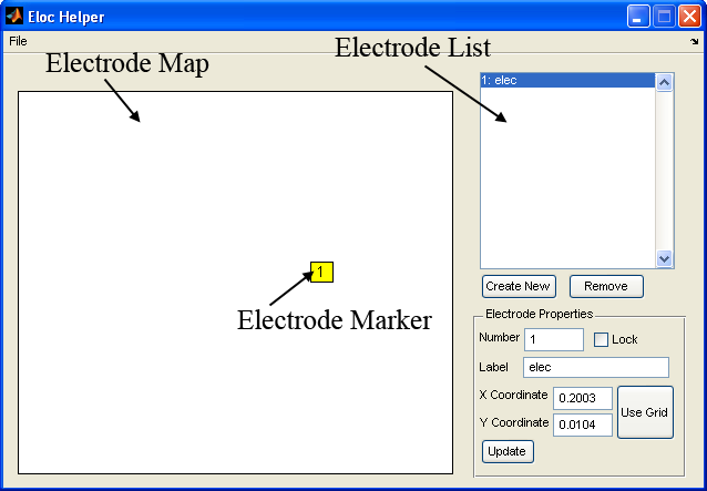

  2. Click File>New>ECoG Montage File to start working on a new ECoG montage file. Since ECoGs are taken using an electrode grid, you will be given a square electrode map.
  3. Create your first electrode:
    1. Click the "Create New" button.
    2. Set the coordinates by clicking the "Use Grid" button and then clicking on the blank electrode map.
    3. Click the "Update" button after which you should see an electrode marker appear in the location you clicked on in the previous step. Notice that the marker is labeled with the number "1" (i.e., the value that was set automatically for the number property of the electrode) and that the electrode list has a new item "1: elec" consisting of the electrode number and label. Try changing the number and label to something else and clicking "Update." Keep in mind that the number must be a strictly positive integer (i.e., 1, 2, 3...) and that the label must be no more than 4 characters. Image:elocHelperTutorial1.png

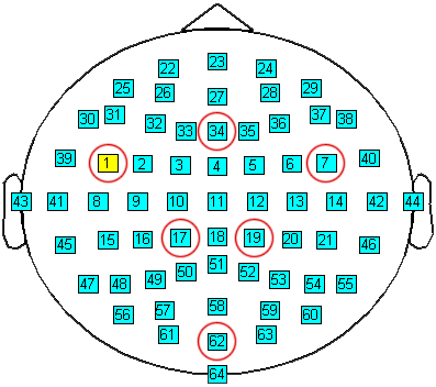

"eeg58.loc" is a montage file for an electrode cap with 58 electrodes. The electrode layout for the data we'll be analyzing later is very similar, but it has 6 more electrodes which are marked in the diagram below. So, to create the 64 electrode montage file, we can simply modify the 58 electrode montage file that we've already imported. When we do this, we must make sure that the numbers in the new montage file are the same as in the diagram below as these numbers correspond to channels on an amplifier. Image:elocHelperTutorialEloc64.png
In Eloc Helper, when an electrode is added with a number that is already taken by another electrode, the old electrodes are displaced in order to make room for the new electrode. This is also the case if an electrode is edited to have the same number as another electrode in the list. So, the easiest way for us to build the 64 electrode montage file from the 58 electrode montage file is to add the highest number electrodes first. So, we begin by adding electrode 62 (as labeled in the diagram above):
  1. Click "Create New" to add a new electrode. By default, this electrode takes on the number 59, the next available number.
  2. Change the number to 62, the electrode we want to add.
  3. Check the checkbox labeled "Lock". This prevents the number from being automatically changed as explained above.
  4. Change the label to "Oz", the 10-20 pneumonic for the location.
  5. To set the X and Y coordinates, click "Use Grid" and then click on the electrode map where the missing electrode should go.
  6. Click "Update" to insert the new electrode. Just as before, the new electrode appears on the electrode map and on the electrode list. This time, however, the text in the electrode list appears as "62*:Oz". The "*", in this case, is to indicate that this item is locked.
Now, repeat the same process in the order specified for the electrodes and their respective labels summarized below. As you add each electrode, notice how the electrodes already in the list move only enough to make way for the new electrode. Also notice that the electrodes you've locked will not move at all.
Number 10-20 Label
34 Fz
19 Cp2
17 Cp1
7 Fc6
1 Fc5
