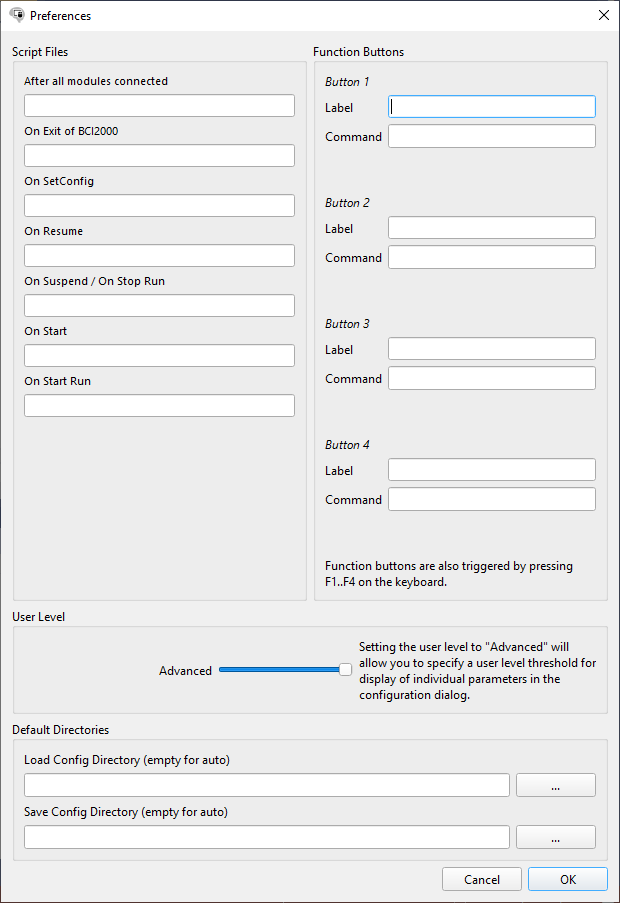

Preferences Dialog
The Preferences Dialog
On the left side, the preferences dialog allows you to associate operator scripts with events, and on the top right, you may configure the main window's function buttons using operator script commands. Please see the User Reference:Operator Module Scripting page for scripting details.
Scripts may be specified from the command line at startup.
On the bottom right, you may specify the global User Level to be one of beginner, intermediate, or advanced. When the user level is set to advanced, a similar ruler control is displayed for each individual parameter in the Parameter Configuration Dialog. For each parameter, its user level is compared to the global user level setting, and the parameter is displayed only if its user level is equal to or below the global setting. Thus, it is possible to simplify the configuration dialog for less experienced users, or for your own convenience, in sitations where full access to configuration options is not necessary. As a typical example, once you have set up a stimulation experiment, you will only change the SubjectName and SubjectRun parameters. Setting these two parameter's user levels to beginner, and leaving the other's at advanced, you may now switch the global user level to beginner, and will only see the two selected parameters displayed in the configuration dialog.

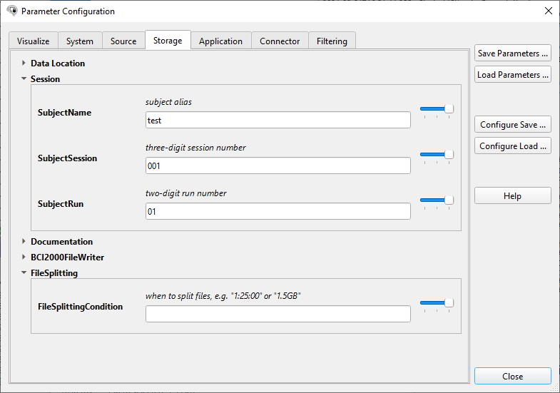

Parameter Configuration Window
The Parameter Configuration Window
On the left side, this window displays a number of register tabs that correspond to parameter sections. Clicking on a tab will display the parameters from the corresponding section.
Within a section, parameters are grouped according to subsections. In most cases, subsections correspond to individual filters; however, filters with a large number of parameters might choose to group them into subsections to make configuration easier. Within subsections, the order of parameter display depends on the order in which parameters are declared in a filter's constructor.
For single-valued parameters, an edit field is displayed that holds the parameter's value. This is also true for list parameters; there, list entries must be separated by white space. Within entries, space characters may be encoded as '%20'. For some parameters, drop-down menus, checkboxes, or chooser buttons are displayed to make it more convenient for the user to enter parameter values. (For programmers, this feature is explained on the Technical Reference:Parameter Definition page.) Matrix-valued parameters display a button to load or save a matrix in ASCII format, and an Edit button that opens up a Matrix Editor Window.
On the right side, there is a pair of Save/Load Parameters buttons that allows saving and retrieving the current configuration to/from parameter files. Behavior of the load/save operation may be fine-tuned using the Configure Load and Configure Save buttons. These buttons both display a list of parameter names, allowing to select parameters to be ignored during load/save operations. This is especially useful to save only a subset of parameters, and thus factor out partial configurations depending on, e.g., the data acquisition module used rather than the experiment itself.
Below these buttons, there is another button labeled "Help". Clicking this button will change the mouse cursor into a question mark. Then, a click on a parameter name or edit field will open the appropriate help page when available. This help button is available only when a recent version of the BCI2000 doc directory is present along with the prog directory where the operator module resides.

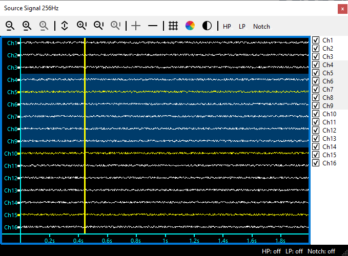

Visualization Windows
A Visualization Window
Visualization windows may be moved and resized, and remember their positions across sessions.
In a context menu, the following options are available:
  • adjusting signal amplitude,
  • adjusting the time interval displayed in the window,
  • choosing signal colors,
  • choosing the number of signals displayed,
  • applying highpass, lowpass, and notch filter combination to the displayed signal,
  • switching between signal display as lines, and colored blocks ("display mode"),
  • switching signal baselines, and unit display on and off.
For signal visualizations, the arrow keys and page up/page down keys may be used to scroll through channels. The full set of keyboard shortcuts is:
up/downback/forward one channel,
page-up/page-downback/forward one screenful of channels,
'b'/spacesame as page-up/page-down ('less'-like shortcuts),
-/+reduce/enlarge the signal,
,/.fewer/more channels,
left/rightslow down/speed up the time sweep,
home/endjump to the first/last screenful of channels,
typing a number and pressing return (or 'g')jump to the specified channel number.
Unit Display
When the signal's physical unit is displayed, it is represented as a white bar:
In the example, there are white markers above and below the bar, indicating the range corresponding to the value written in the bar. These markers may be missing; then the range corresponds to the height of the bar itself.
Finally, the physical unit may be displayed with a white marker attached to the bar:
This display is used for nonnegative signals. Here, the physical unit corresponds to the distance of the white marker to the signal's baseline.
Choosing Signal Colors
Clicking Choose Signal Colors... from the context menu will open up a color chooser dialog. This dialog provides fields for "User defined colors" to the left, defining a list of channel colors, terminated with a black entry.
Signal colors are taken from these fields in the order in which they appear; when there are more signals displayed than colors defined, colors will be re-used in order.
