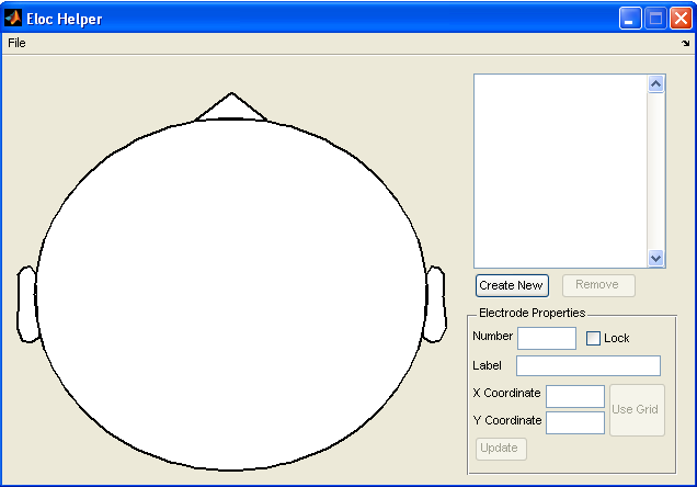

Eloc Helper is a tool for creating EEG or ECoG montage files. Image:elocHelper.png

Create New - Clicking this button adds a new electrode with a default number and label.
Remove - Clicking this button will result in the removal of whatever electrode is selected in the electrode list box.
Use Grid - Clicking this button and then clicking on a valid electrode location on the electrode map will set the X and Y coordinate fields to the X and Y coordinates of the location that was clicked.
Update - Clicking this button will validate the electrode properties. If all properties are valid, the current electrode properties and the electrode list will be updated accordingly.
Fields
Number - This field corresponds to the order of the electrode in the file. Typically, it would also correspond to the amplifier channel number. You may enter any strictly positive integer (e.g., 1, 2, 3...). If the number entered is already in use by another electrode, the updated electrode will be assigned that number and other electrode numbers will be shifted to make room. If you prefer for the entered value not to be changed, check the "Lock" checkbox.
Lock - The "Lock" checkbox protects the electrode number value thus preventing the value from being changed automatically as explained in the description of the "Number" field.
Label - The "Label" field is a string of up to 4 characters that identifies the electrode. Typically, the 10-20 naming and positioning scheme is used to determine the label values so as to indicate the approximate location of the electrode. See User Tutorial:EEG Measurement Setup for more information about the 10-20 system.
X Coordinate - The "X Coordinate" field corresponds to the normalized X coordinate of the electrode. The simplest manner of setting both the X and Y coordinates is to click the "Use Grid" button and then click the desired location on the electrode map.
Y Coordinate - The "Y Coordinate" field corresponds to the normalized Y coordinate of the electrode. The simplest manner of setting both the X and Y coordinates is to click the "Use Grid" button and then click the desired location on the electrode map.
