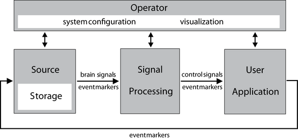

While BCIs can differ widely in the nature of the physiological components they use, the signal processing they perform, the feedback they provide, or the underlying training and operation paradigm, they all need the same four elements: data collection, signal processing, an output device and manual or automatic parameterization and configuration. Therefore, it seems to be a natural choice to partition the system into four modules with respect to functionality. It is conceivable that for certain BCIs, the chosen decomposition might be overkill, or even unfavorable, but still these modules seem to be the most appropriate for a variety of systems.
In accordance with this decomposition, BCI2000 consists of four modules that communicate with each other. (See Figure 1.) These modules are called Source, Signal Processing, Application, and Operator. We will refer to the three modules Source, Signal Processing and Application together as core modules.
Fig. 1 The functional modules and their interfaces
Enlarge
In a binary distribution, the four modules correspond to executables. For modules other than the operator module, executable file names vary, reflecting specializations of the generic modules.
