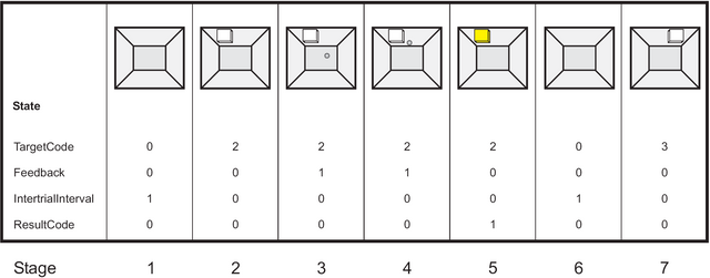

Events
Events Summary
The following table indicates which events exist, and the temporal sequence in which they occur. Trial-based applicatons proceed in "phases"; each trial consists of a PreFeedback, Feedback, and PostFeedback phase, and is followed with an ITI (Inter-Trial Interval) phase lasting until the next trial begins.
Events marked with * may occur multiple times in a row.
Progress from one application state to the next will occur according to the sequencing parameters, or if requested by a handler via its doProgress output argument (see Input events below).
Sequence of events    Phase     Typical application behavior
OnPreflight
OnInitialize
OnStartRun       display initial message such as "please prepare"
DoPreRun*   PreRun
Loop {
    OnTrialBegin       display target
    DoPreFeedback*   PreFeedback
    OnFeedbackBegin       show cursor
    DoFeedback*   Feedback   update cursor position
    OnFeedbackEnd       hide cursor, mark target as hit
    DoPostFeedback*   PostFeedback
    OnTrialEnd       hide targets
    DoITI*   ITI
OnStopRun       display final message, e.g. "finished"
OnHalt

States
TargetCode
During a feedback trial, this state indicates the user's task, i.e. the target the cursor is supposed to hit. A TargetCode value of zero indicates that there is no target specified; TargetCode switching from zero to nonzero indicates the beginning of a trial.
ResultCode
At the end of a feedback trial, ResultCode is set to the target code of the outcome, i.e. the target that was hit by the cursor. When a time of PostTrialDuration has passed, ResultCode is reset to zero.
Feedback
This state's value is 1 when the cursor is displayed on the feedback screen. Typically, this also implies that the cursor moves according to the control signal.
