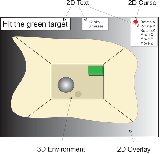

The 2D Overlay
The 3D display can be overlayed by a 2D display (see figure above). This overlay supports a picture with alpha channel (i.e., transparency map), 2D text and a 2D cursor.
Overlay Picture
An overlay picture can be defined by loading it from disc. This picture is stretched to match the window size. Optionally, a transparency map can be defined (i.e., in essence, another picture) whose brightness level defines the s transparency of the overlay. This can create an effect as shown in the figure. Once defined, an overlay image can be turned on or off.
2D Text
The system supports any number of 2D text elements. Text elements are always displayed on top of the overlay picture. The texts' background is transparent and the text itself does not destroy the overlay picture. For each 2D text element, the following properties can be defined:
  • Position (XY)
  • Font
  • Size
  • Color (RGB)
2D Cursor
The system supports one 2D cursor that is always presented as a circle that is filled with a particular color. Specifically, a 2D cursor has the following properties:
  • Position (XY)
  • Size
  • Color (RGB)
