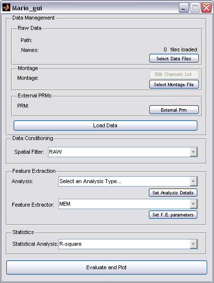

After having run mario.exe, press "Select Data Files".
Image:Mu Rhy5.jpg
A dialog window will ask you to select the dat files. You can either select a single data file, or select multiple files. This time, we will select all files in the dataset.
A green box will surround the Raw Data box in the main window.
As an optional (but recommended) operation, click on the LOAD MONTAGE button and choose the mmf file. This will allow you to see the labels of each channel and allow you to apply spatial filters that depend on the electrode position.
You can load an additional parameters file with choices different from those used during the experiment.
At this point, you can check that Mu is selected in the Analysis menu (indicating that a Mu dataset has been recognized) and click on the LOAD DATA button to confirm your choices. This will enable the EDIT CHANNEL LIST button that you can use to select the channels you want to include in your analysis.

The Analysis field in the Feature Extraction panel will appear automatically according to the files loaded, while the Feature Extractor field shows the only currently possible choice.
You can view/edit analysis details by clicking on "Set Analysis Details" and "Set F.E. parameters"
This second form reports all the settings for the parametric (autoregressive) spectral estimation stage. Most of the values are set after the corresponding values used on-line (see BCI2000 setup for Mu). Using the settings in the figure, the analysis software will:

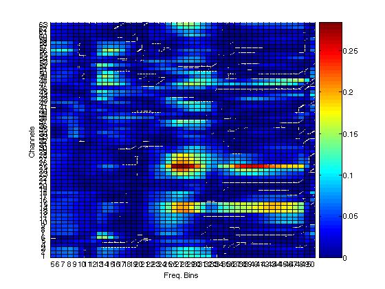

The first figure that appears is the R-square matrix (channels x frequency bins)
R-square Matrix
The r-square matrix highlights the most relevant spectral features for the separation of the two classes of EEG - Cursor Up (target 1) and Cursor Down (target 2).
Image:Mu Rhy8.jpg
Each row of the matrix is related to a single channel, while a column represents a frequency bin (labeled with its central frequency). The color codes the statistical significance of the difference between the two kinds of evoked potentials.
Thus a red color would mean that, on that channel and for that frequency, the "Up" EEG is significantly synchronized with respect to "Down" EEG.

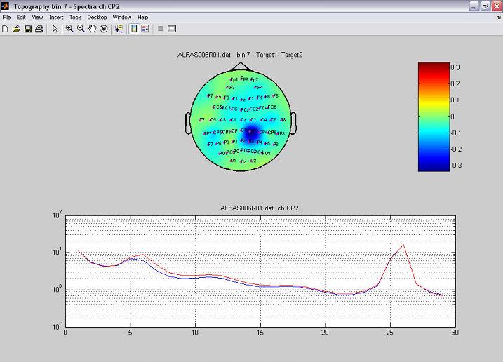

Clicking on a cell of the matrix will open two more windows:
  • Power spectral distribution of the selected channel
  • Topographic maps at the selected frequency.
You can choose whether to overwrite or to put the most recently evoked figures beside the previous one. Two sets of waveform/topography figures are available, and are linked to the click of the left, the central or right mouse button. Left Button will create/overwrite a first figure, Right Button will do the same on a second figure, the Central Button will always open a new plot.
Power Spectra and Topographic Plots
In the lower panel you can find the spectral density of power for both classes of EEG. The Blue line refers to the "Up" condition, while the Red line refers to the "Down" condition. We can see that at the vertex the "Down" condition is generally more synchronized than the "Up", with maximal difference in the beta band, consistently with what is shown by the R-square matrix. The proportinality between spectral differences and R-square is anyway rough, since r-square is sensitive to the dispersion (variance) of single trials; thus, small differences between spectra could bring to a high r-square, if they were very reproducible.
The peak around 50 Hz is due to mains disturbance; this also allows you to appreciate the leakage introduced by the spectral estimation.
Over the spectral graph, a topographic plot shows the scalp distribution of the r-square.
The color coding is the same as the r-square matrix figure, and values on each channel are interpolated to create a continuous bidimensional map. The higher the number of electrodes, the more accurate is the map. With Surface Laplacian spatial filtering, the number of channels shown on the scalp may not coincide with the whole number of electrodes, since the value of the laplacian is not computed on the border channels.
