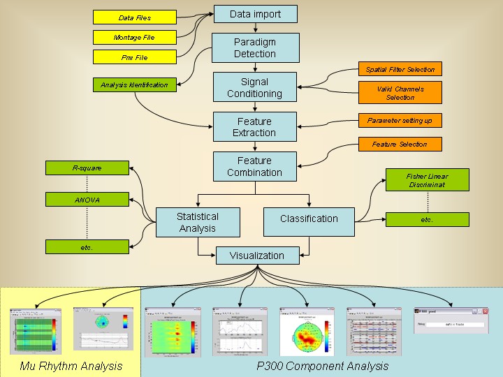

Graph of modules
Enlarge
Graph of modules
Here you can see a simplified version of the functions graph with their relationships (click to enlarge).
